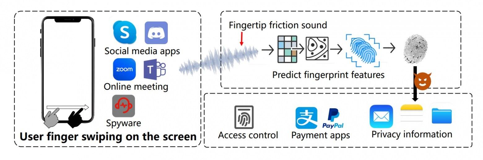

Recently, researchers from the USA and China published a study proposing an extremely unusual method of stealing fingerprints. Imagine receiving a call from a malicious actor or connecting to a conference call from your smartphone where an attacker has access. During the call you perform actions on your phone, naturally swiping your finger across the screen. The sound of such movements is well-audible through the built-in microphones of smartphones meaning a potential attacker can record and analyze this sound. From this they can reconstruct certain fragments of a fingerprint which can be sufficient to unlock your smartphone using an "artificial finger". Just think about it: from these "rustles" one can deduce the pattern on the fingertip, making it a fantastically beautiful attack through external channels!
How to steal a fingerprint through sound?
The general scheme of the new PrintListener attack is shown in the image:
If the potential victim swipes their finger across the screen during a call the attacker can reconstruct fingerprint elements from the sound. When a user swipes their finger across the screen they produce an almost inaudible noise to the human ear. These roughly speaking "rustles" are non-uniform - their characteristics change when larger nodes in the fingerprint pattern, such as "loops" and "arches" touch the screen. If the noise is recorded using a sensitive microphone and later analyzed based on the data obtained one can reconstruct the approximate location and pattern of such nodes.

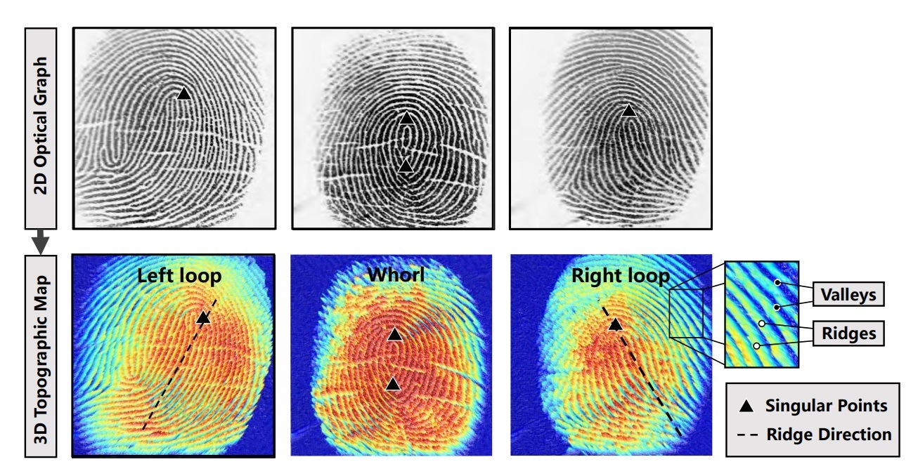

Prominent elements of the fingerprint pattern are crucial for determining whether the scanned fingerprint matches a previously stored one. To make the attack somewhat realistic the authors of the new study did extensive work. Firstly, they created an automated system to search for sounds resembling the rustling of a finger moving across the screen, eliminating the need to manually search for these relatively quiet and rapid events. Secondly, they created a large database containing photos of fingerprints and the corresponding sounds of finger movements on the display in different directions with varying background noise for different smartphone models and so on. In total, 65 volunteers participated in the experiment and 180 fingerprints were scanned. These data were processed using a machine learning algorithm. The trained algorithm was able to predict certain characteristics of the fingerprint fairly confidently solely based on the sound of finger movement on the smartphone surface.

PrintListener is not the first type of attack on fingerprint scanners. In 2017 a research paper was published where a random fingerprint was applied to the scanner instead of a real user's and in some cases it worked! Why? In many modern smartphones the fingerprint scanner is embedded in the power button which is quite narrow. By definition, such a scanner only sees a fragment of the fingerprint. Furthermore, scanners are designed to focus on the prominent elements of the fingerprint pattern.
If a synthetic finger with a loop roughly matching a loop on a real fingerprint is detected the scanner may authorize the user! This attack was named MasterPrint.
Another important parameter in the operation of a scanner is the false positive rate. An ideal fingerprint scanner should only accept the applied finger in the case of a 100% match with the pattern. However, using such a sensor would be impractical! Each time a user applies their finger slightly differently - at a different angle slightly higher or lower. The finger can be dry or wet, dirty or damaged. To account for the imperfections of the real world the scanner is adjusted to grant access not only in cases of exact matches but also in situations where it "almost matches the template". This inevitably leads to false positives: when another person's finger is applied but the scanner thinks it is "as it should be". The typical percentage of such unwanted detections ranges from 0.01% (in the strictest case) to 1%. The latter option would be more convenient to use but it increases the likelihood that someone else will apply their finger to someone else's smartphone and the device will be unlocked. The MasterPrint attack showed that a synthetic fingerprint with a common element like a "loop" triggered in 2.4–3.7% of cases with partial recognition right from the first attempt. If multiple attempts are possible the probability of false positives increases. In the experiments 12 consecutive attempts passed the fake fingerprint in 26–30% of cases! In these experiments the false positive rate was 0.1%.
The PrintListener attack builds on the ideas laid out in the 2017 MasterPrint study. Processing audio information allows for reasonably confident identification of a significant node in the fingerprint pattern. It essentially enables an attacker to target fingerprint scanners not randomly but using a reconstructed node based on sound. The attacker can then print a finger with a synthetic fingerprint incorporating the predicted significant element. With an acceptable false positive rate of 0.1% the PrintListener attack successfully deceived fingerprint scanners in 48–53% of cases. Even in a more stringent scenario with an acceptable false positive rate of 0.01% the biometric scanner could still be hacked in 7.8–9.8% of cases. This is significantly more effective than the MasterPrint attack. Moreover, in all cases no more than 5 attempts were made to scan the synthetic finger aligning with the real limitations on biometric authentication in the same smartphones.
